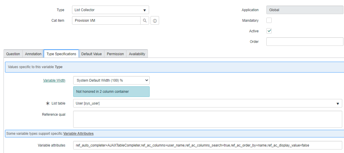

I have a list collector variable referencing to the user table. I just need my end user to search the users with the help of userId(user_name) instead of name. What attribute i need to use?
I have tried glide_list,ref_auto_completer=AJAXTableCompleter,ref_ac_columns=user_name,ref_ac_columns_search=true,ref_ac_display_value=false
It didn't worked. any help on this?

this should be fine; But remember this point
1) the display value i.e. name field will still be shown when user types in user name value
2) removal of name from the search is not possible

Thank you for the response. Yes I need to search with name as well as userID. Currently it is working only for name. And the mentioned attribute is not working. When i put user_name (userID), not getting user in the list collector.

Thank you Ankur, it didn't show up in item view. But it worked in portal view, thank you..
