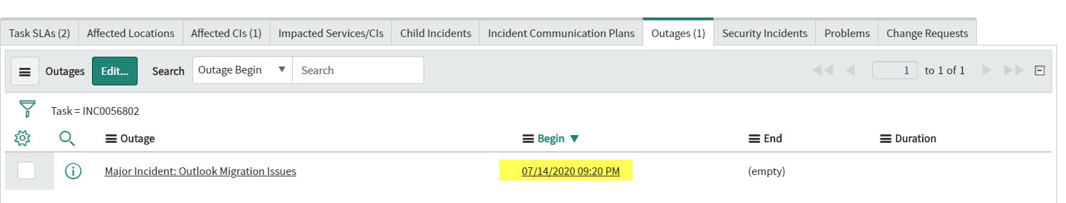

So in our environment when an incident is promoted to major incident an outage record is created when the outage begins as well announcement record to post on the Service Portal.  We have recently noticed that the  major incident time stamp is different on outage records and announcement record they are both off by a few hours which makes the announcement not show up in the Service Portal.  This was not an issue before.  Are there any spots that I should check to fix this issue?  Portal Widget perhaps?  I have already verified that the user and system time zones are the same and again this is only occurring for the outage and announcement records.

Thank you for responding.  I have looked at business rules, client scripts and even UI policies/actions and cannot find anything.  I stumbled across a flow designer that was created for incident communication and it looks like this is where both the outage and announcement are both created.  See attached.  Could this be were the issue lies?  I am not sure of how this time is set when these are created.  Please advise.  find_real_file.png
Yeah, that looks like that it's.
So that flow is creating the record and you see next to begin it's using the trigger > run start time - you'd want to use most likely a date/time from the incident record (so you see the other fields say "trigger - incident record - field name".
You'd want to maybe use the incident record - updated field perhaps.
So whatever field from the incident record that works for you.
