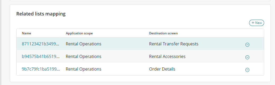

I am configuring some related lists for a record screen on mobile, but I haven't figured out how to manipulate the order they're displayed in the agent app.
Does anybody know more about it?
Example:
This is the configuration in the platform, Mobile App Builder:
This is how they appear configured in Studio:
This is how they're finally displayed:
I am not sure what is ServiceNow considering for rendering the related lists in the app.
I'd like to know if there is a way to easily change the order of those related lists, I tried looking for an "Order" field in the Related lists mapping [sys_sg_related_list_map] table but had no success on that.

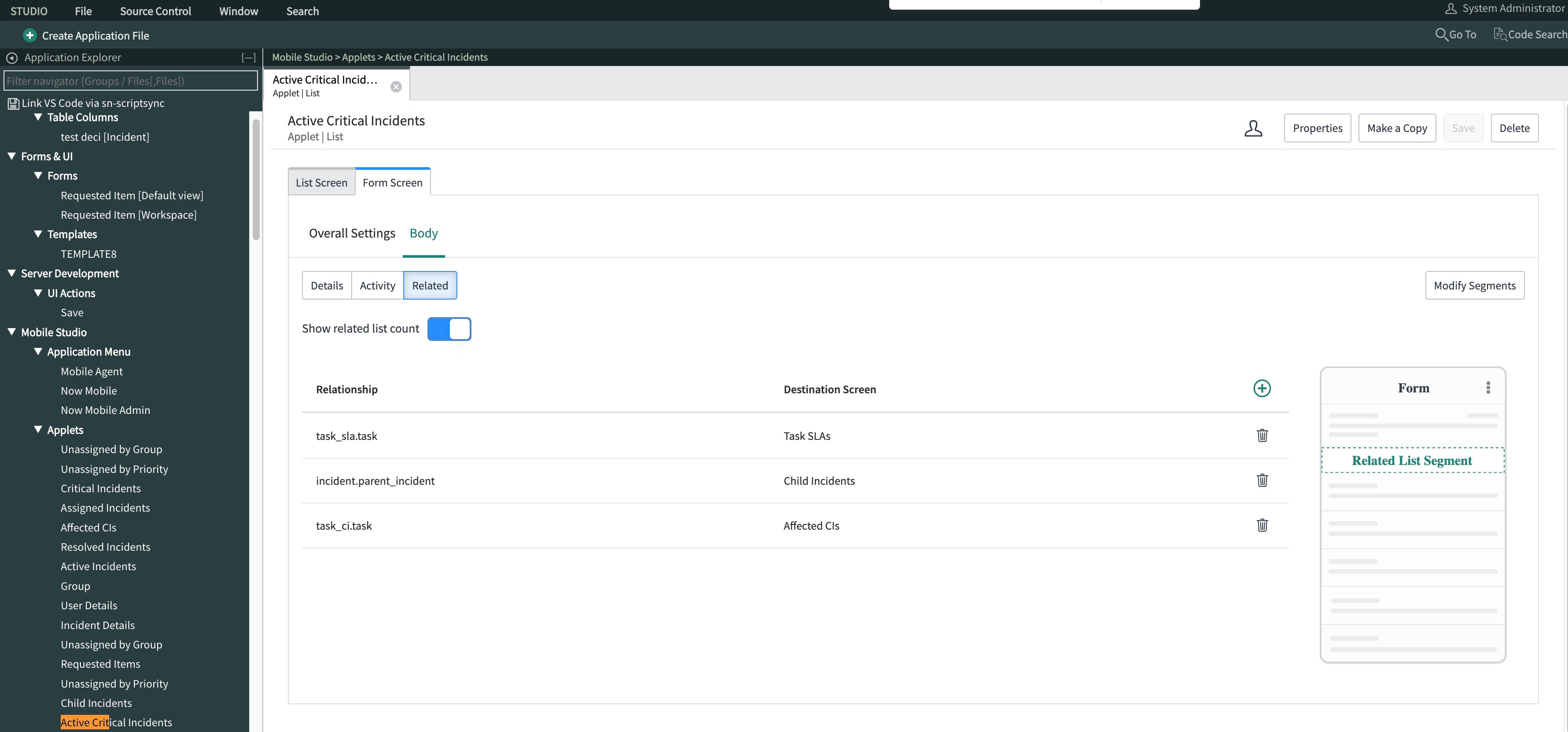

As Ivan mentioned, there is no order field explicitly available in the 'Related List Mapping' on the Mobile App Builder or the Mobile Studio.
However, note here that the related lists appear on the applet details screen exactly in the same order as they appear on the Related List Mapping configuration.
Check out the positioning of the related lists in the mapping vs the related lists positions in the applet in the below 2 example scenarios:
Scenario 1: Notice the related lists on the Active Critical Incidents applet:
Scenario 2: Here we switch the position of the related list by using the delete icon in studio (- button for MAB) and re-adding the relationship
So, in order to rearrange the related list, you would have to remove them from the Related List Mapping and add them back according to your required order. This seems to be the only configurable option available at this point.
