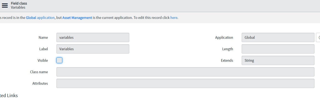

Hi, @Ivan Betev  and @David Ha ,
I tried creating a parameter screen which has inputs and variables defined.
Unfortunately, there are no input type matching to sc_task.variables.
 If input of type string is utilized then it appears just as a single textbox.
Hi Afsar,
I couldn't even make the parameter (or input form) screen work in my instance, I'm always getting an error - Unsupported screen - when I try to check it on mobile.
The main problem won't be solved anyway, as this thing is not dynamic.
Regards, Ivan
You are right @Ivan Betev .
I think the possible solution for this is to create String data parameters and try to save in required catalog variables using script in Action Item.
