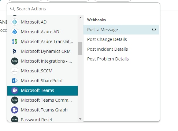

I am also working on pretty much the same thing! Unfortunately, I'm having the same problem as you. I'm sure you've done some digging yourself, but here's some info that I have gathered over the last day on this:
It seems that if you are using the "Microsoft Teams" spoke (screenshot below) you cannot specify a GroupID or Channel ID which are needed for mentioning in a teams channel:
You would instead need to use the "Microsoft Teams Graph" here:
