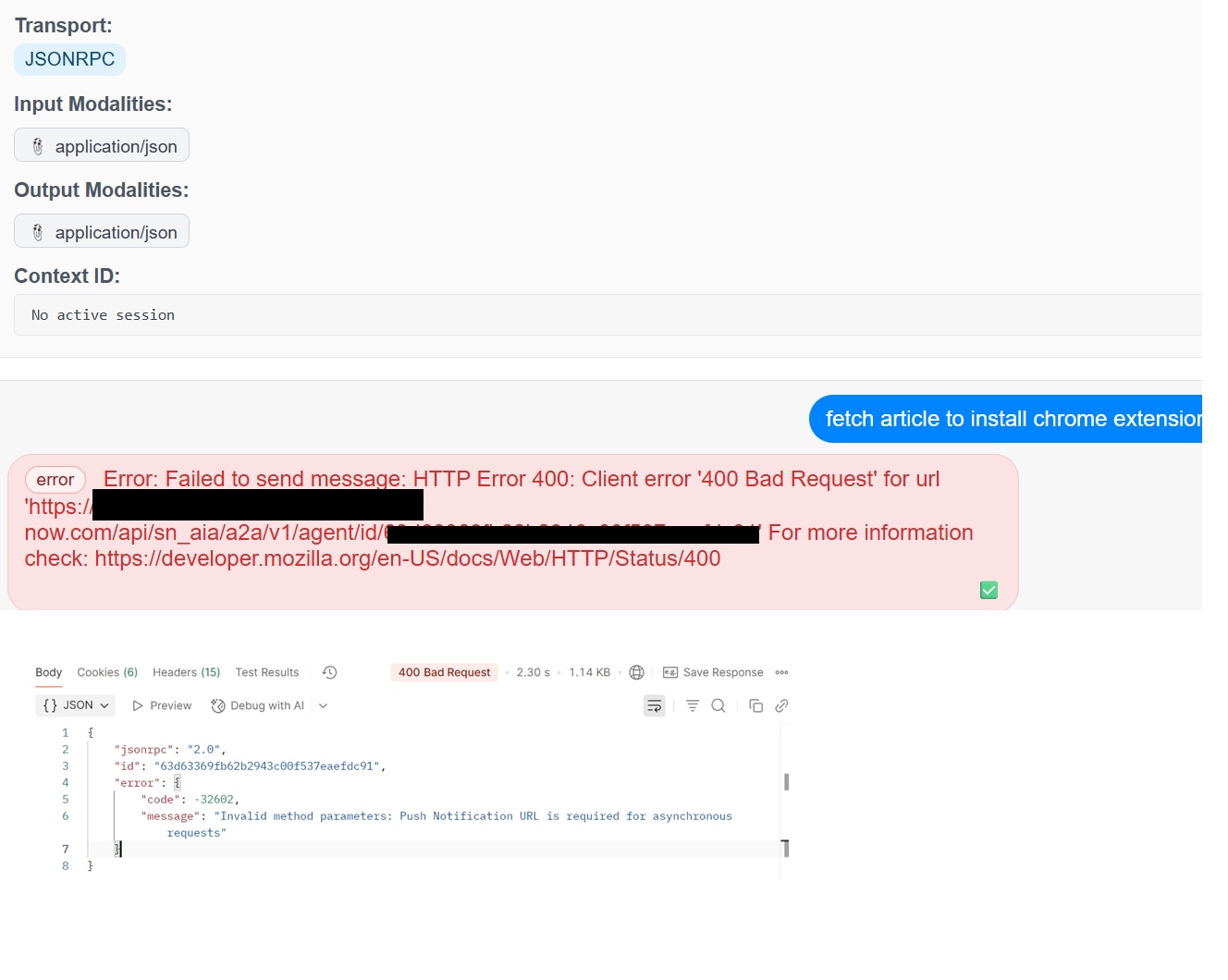

We tried the above steps , however , we are getting a 400 bad request for the json rpc message sent
Also, we are not able to switch the radio button from the default asynchronous to synchronous in the setting screen in
- Yokohama Patch 11+ (January 2026)
Please help to make the agent execution synchronous or fix the asynchronous payload ,what should be the callback url if we are testing locally ?
02-03-2026 07:04 AM
We tried the above steps in Yokohama Patch 11+ (January 2026), however, we are getting a 400 bad request for the json rpc message sent
Also, we are not able to switch the radio button from the default asynchronous to synchronous in the setting screen in ai agent studio .Please help to make the agent execution synchronous or fix the asynchronous payload, what should be the callback url if we are testing locally?
