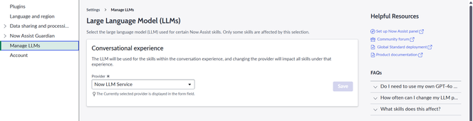

10-07-2025 10:07 PM - edited 10-07-2025 10:08 PM
Hi @rehanumant,
In the recent update to the Now Assist Admin (under the Settings Panel), you can see that you can individually set the default LLM provider for AI Agents and Now Assist Topics separately. Refer to the attached images for better understanding.
Let me know if this helps and solves your issue!
