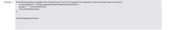

  • I am using and indicator source/indicator to get this information
  • I created a bucket breakdown source
  • With a scripted breakdown mapping, that returns an integer associated to every assignment group.
  • The problem with that I am receiving the following error, when I run the indicator's job
Request:
  • Is there a solution to my error?
