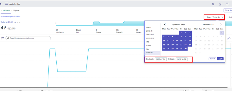

Hi @Veer_P ,
You can fetch the single records through the analytics hub by showing records for the automated indicator:

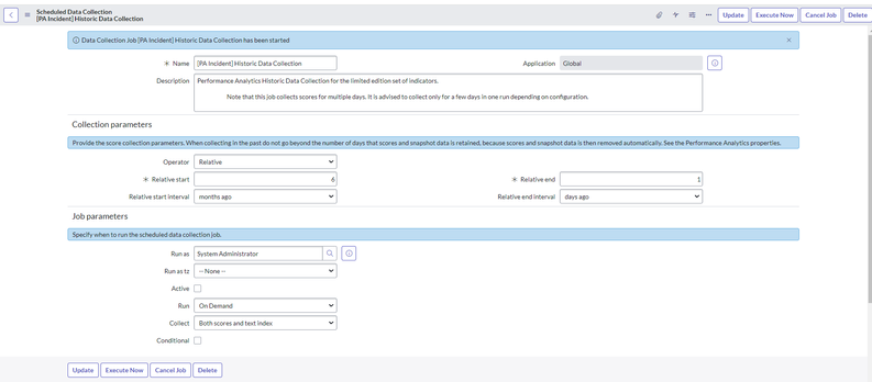

@Veer_P To get historical data (last 6 months), you need to run the historical jobs. You need mention below details in job and attach it to indicatory then execute.

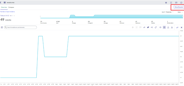

Once job is successfully execute, you can go analytic hub of that indicator and select the 6 month duration to see the graphical view.

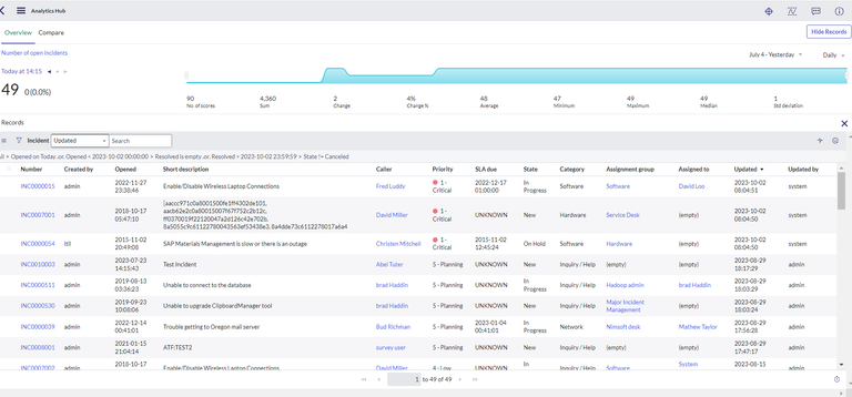

Click on "show records" to get the list view of records to extract it.
