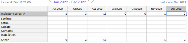

the gs.info output shows appropriate RITM numbers and topics and the scorecard for the indicator lists all of the available options, so the script is definitely getting the right data, but the indicator scores are all showing up in the catch-all "other" breakdown item rather than the appropriate topic.

Ok. And what happens when the indicator is shown on the analytics hub?
Does it show the breakdown on the left? Do you have a screen?
12-13-2022 09:32 AM
All of the items end up in the other category:

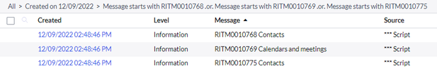

When I search the logs for those exact three items this is what the script is sending:
12-13-2022 10:12 AM
Yeah... it is not "breaking down anything".
