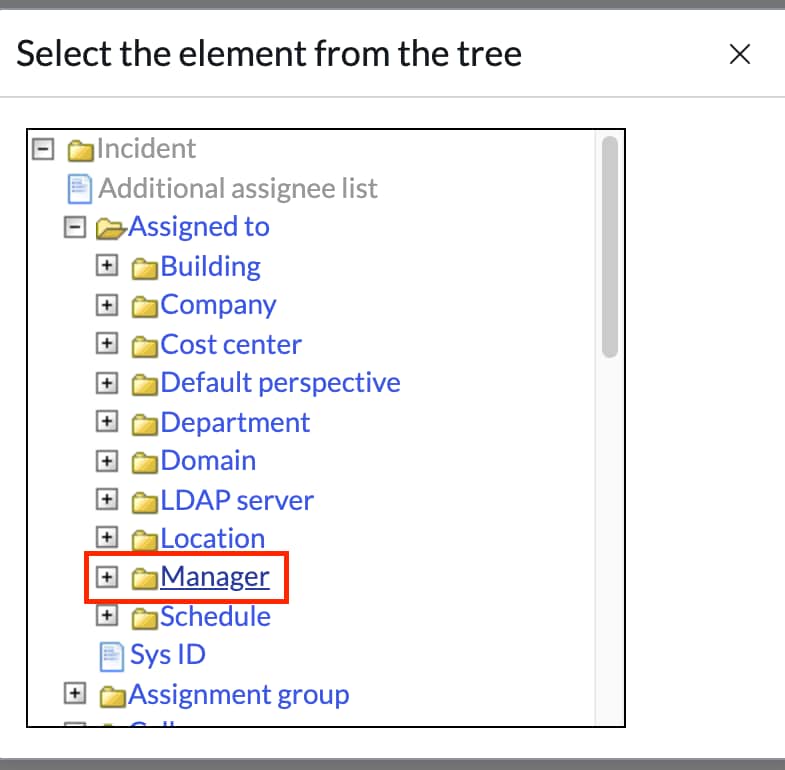

In your "Interactive filter reference" tab you link/map filter it to reference field "Assigned to", while instead you should link to assigned to.manager (so manager of assigned to). You can click on plus button next to assigned to when you select the field to see associated fields.
Hello again olgaredkina. Happy Friday.
Yes, you are correct. I can change the reference field so when I chose 'Assigned to' => 'Manager' it looks like this below.
However dropdown filter still only shows a list of the agents as before.
If you have another idea let me know but don't worry too much as it won't be the end of the world. More of a 'nice to have'
