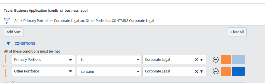

We have a dashboard for a particular Business Unit with multiple reports of Business Applications for that particular BU.
This is what the filters look like:
The Primary Portfolio is a reference field that is sourced off the "Portfolios" table, while the Other Portfolios is a List collector field that can have multiple Portfolios.
We now have the requirement to make this dashboard work for all BUs by adding an Interactive filter (multi-choice) with which they can select their BU/s and see the dynamic reports. It would have been easy requiring a single multi-choice Interactive filter for "Portfolios" but it can only work with Primary Portfolio at a time. It doesn't work with Other Portfolios simultaneously and doesn't have the mapping option to that field either.
Is there a way to create a custom Interactive filter (using Dynamic Content block) with multi select dropdown that works with the reports adding both the conditions at the same time?

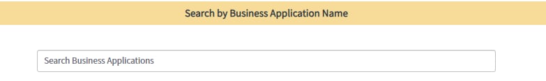

Thanks, Adam. Is there any other way apart from the custom table route? With the help of your K19 video, I was able to create a custom widget that works with the name of the Application.
	<script>
		var my_dashboardMessageHandler = new DashboardMessageHandler("businessapplookupbyname");
		function searchForStrings (str) {
		var filter_message = {};
		filter_message.id = "businessapplookupbyname";
		filter_message.table = "cmdb_ci_business_app";
		<!--     Add your own filter query logic here -->
		filter_message.filter = "nameLIKE" + str;
		SNC.canvas.interactiveFilters.setDefaultValue({
		filters: [filter_message]
		}, false);
		my_dashboardMessageHandler.publishFilter(filter_message.table, filter_message.filter);
	</script>
	<br/>
	<!--<input id="myCustomSearchString" type="text" value="" onChange="searchForStrings(this.value);" />-->
	<div class="form-group row" style = "margin-left:0px;margin-right:0px">
		<div class="col-md-8 col-md-offset-2">
			<input id="myCustomSearchString" placeholder="Search Business Applications" type="text" value="" onChange="searchForStrings(this.value);" class="form-control" />
		</div>
	</div>
</j:jelly>
I was hoping to create something similar but wasn't able to find a way to add a choice dropdown.
