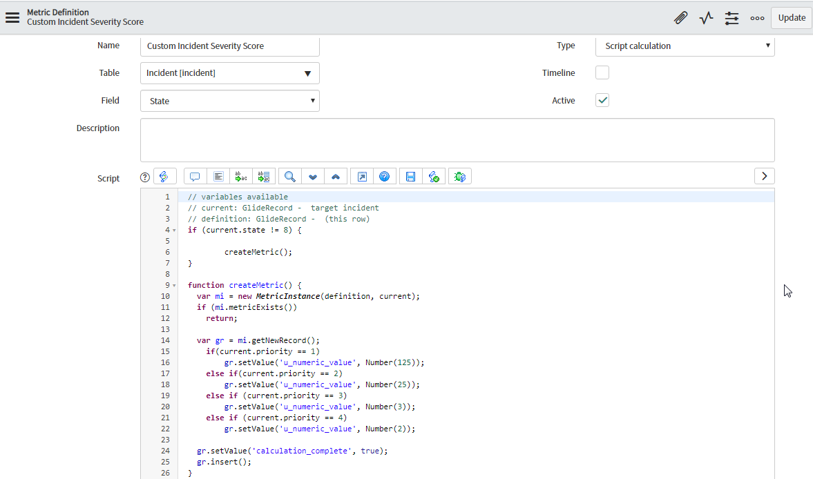

You can create metric definition to calculate score according to priority and define report on 'incident_metric' to get real time score value.
Metric definition.. you should create one custom integer field on metric_instance to store the score value, that is referred in below metric definition as 'u_numeric_value'
Report on 'incident_metric' will look like something below:
You can apply filter conditions and visualization on the report as per your requirement.
Check if it works for you.
‎03-02-2020 06:39 AM
Sushil,
This would work great; however, using the Metric definitions is not an option at this time. Management has decided it is a drain on the system and will not allow me to create them. I will keep this information on hand for future reference, I may be able to convince them if I can't get other options to work.
