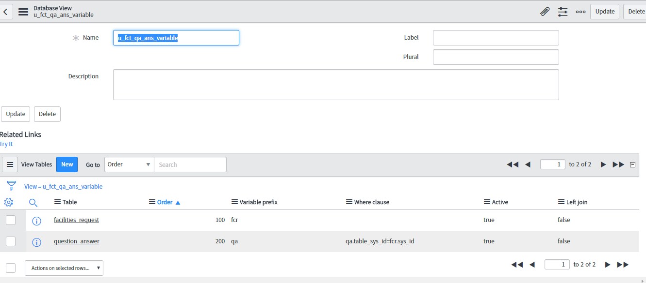

‎09-12-2017 11:11 AM
Hi Lee,
You need to use item_option_new (Variable table). In order to get what you want you can use something as below
For testing I have taken Facilities_request table you can use u_private_incident table. Rest order, where clause remain the same.
Once done create a report on database view that was created with below columns & you get what is expected
If required you can then group the report by using Group by -- Number.

‎09-13-2017 01:46 AM
This was what I was looking for, thanks Jaspal!
