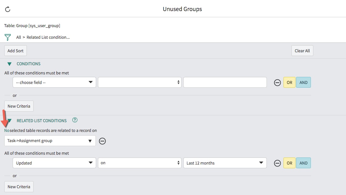

‎08-15-2019 10:39 AM
This report would give you all assignment groups that have not had any task assigned to them in the last 12 months. This would miss a group that did have one but was reassigned leaving no tasks with it currently assigned to them.

‎08-19-2019 01:36 AM
Thanks Adam, i couldnt run this as a report because i couldnt located the related list conditions. I can however set this up as a filtered view which is what i have and it seems to be run ok. Thanks for your help.
If there is a way to run this as a report i am clearly missing something or its just because we are using an older instance. I am trying to run this on Jakarta before we move to London in a few weeks time.
