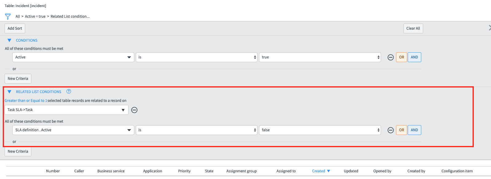

10-03-2019 03:43 PM
So if you're attempting to report on active incidents which do not have an active SLA, I would try making your report on the incident table and adding the Task SLA table as a related list condition in your report. From there you can dot-walk to "SLA definition.active" and set the condition to false. Then you can build the incident conditions to match the type of incident you want to report on.
10-07-2019 03:00 AM
Did not work! Do you believe it?
