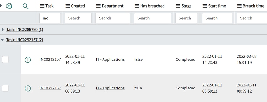

Need a help in generating a SLA Report. I wanted to find number incidents never breached the SLA.
we have 2 SLA one is for Response and the other is Resolution. If one among them is breached, then it is a breached ticket.
I tried to filter from Task_SLA table here I am querying with my specific filters(SLA Name) and group by task. I would get something like this below: how .do I put some logic or a condition to see "Has Breached" is false for both the entries on the incident record.

So if we run a report on incident SLA, with some has Breached condition. I may get the SLA Level whether the SLA is breached or not, from the above screen shot, I will see the record "INC0292157" which actually breached on of SLAs and that will not serve my requirement.
I tried some filter query but unable to get the logic here, I queried the Task_SLA table and grouped by task number and then I failed to get the records where record is having Has Breached as "False".
