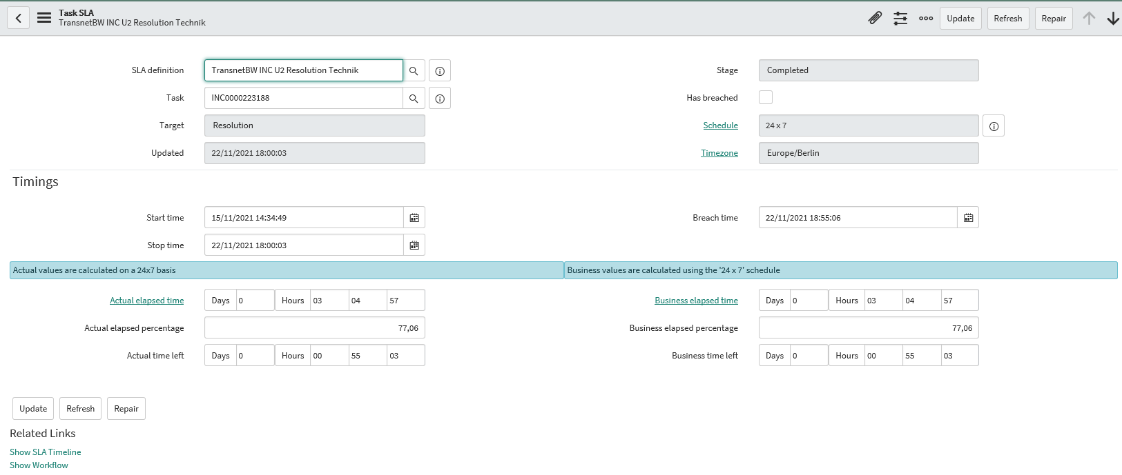

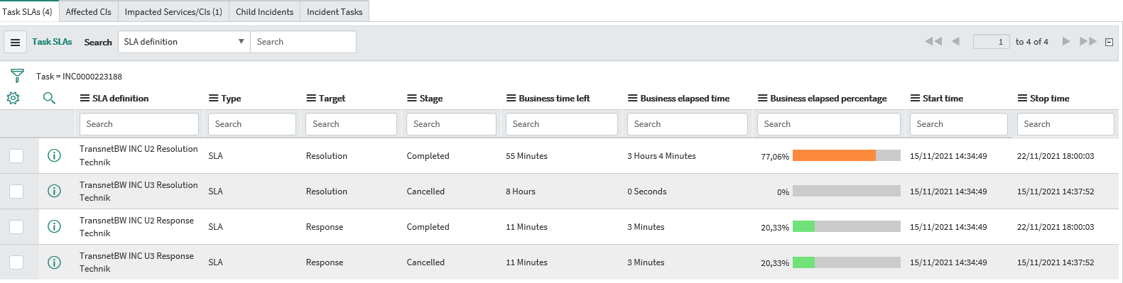

I show you some screenshots from one incident, which has Business Duration 0 Seconds and I don't know why it is 0. For urgency 1 and 2 we use the schedule 24x7 timezone Europe/Berlin. The Duration time is also not yery clear for mee

The Incident duration and business duration fields are basically obsolete at this point. They were used for prior use cases, like the business duration was used for a very old SLA engine/system that ServiceNow doesn't use anymore. The appropriate place to get that information would be from the SLA definition associated with it.
To give more information, here's a support article about it: https://support.servicenow.com/kb?id=kb_article_view&sysparm_article=KB0754082
This is controlled by the mark_closed business rule, but I believe there's issue with it because gs.calDateDiff() is deprecated and may not work properly since the GlideSchedule API is used now.

Normally, these things are tracked via SLA definitions, which is what I mentioned above. That is where you'd track appropriate metrics as you need per the schedule that is relevant to you.
