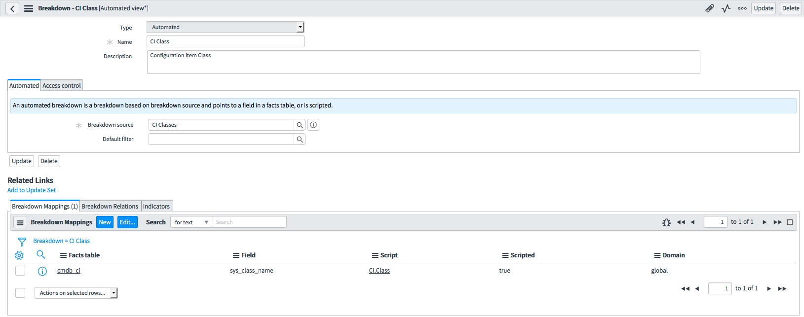

6. create an automated breakdown which will use the script you created. Go to PA>Breakdowns>Automated Breakdowns and click 'New'. Give it a name (in my case 'CI Class' and give it a breakdown source that you created in step 4: 'CI Classes'. Save and then create the breakdown mappings - for the 'Facts Table' choose 'Configuration Item' and select the option 'scripted', then select the script you created in step 5 'CI.Class'.
Mission accomplished. You now have an automated breakdown which will feed daily from the manual breakdown and the scheduled job you created.
