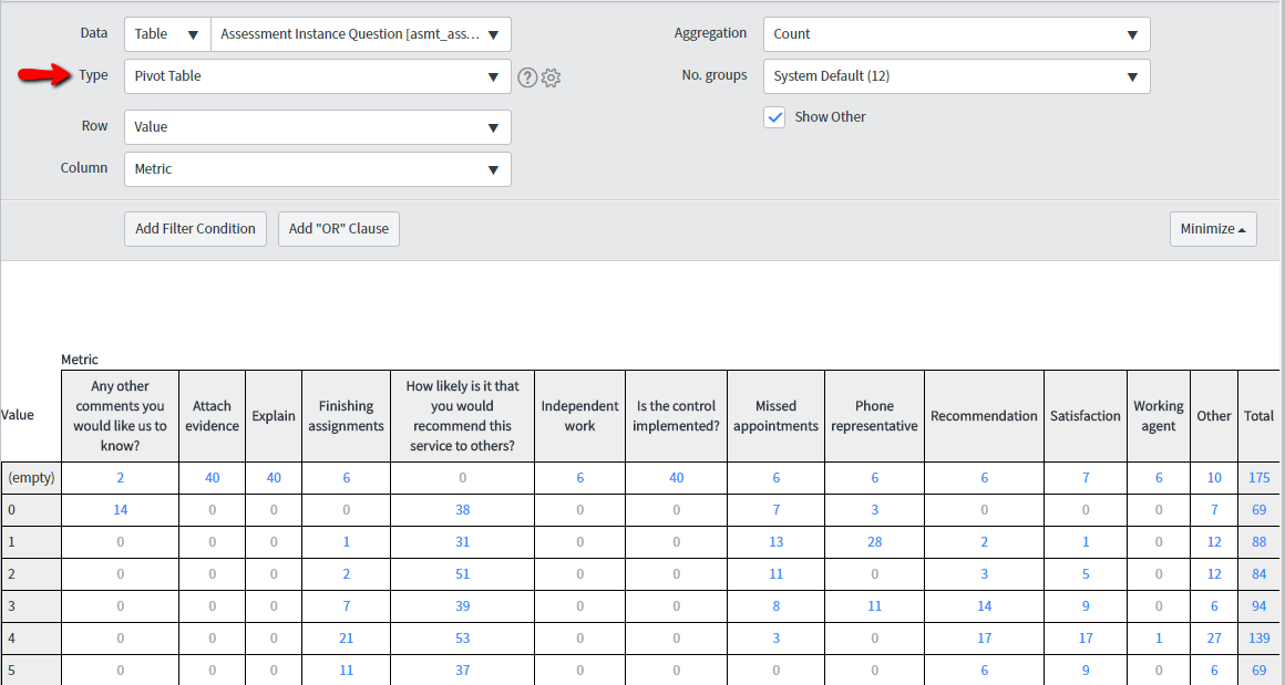

Look into using 'Pivot Tables' for this. The table to use is Assessment Instance Question [asmt_assessment_instance_question] (or the legacy Survey Response [survey_response] table, if you're using it).

Hi Cody,
I don't see how a pivottable will show me this information. A pivottable will calculate the average score for me, but not display the individual results or comments.
