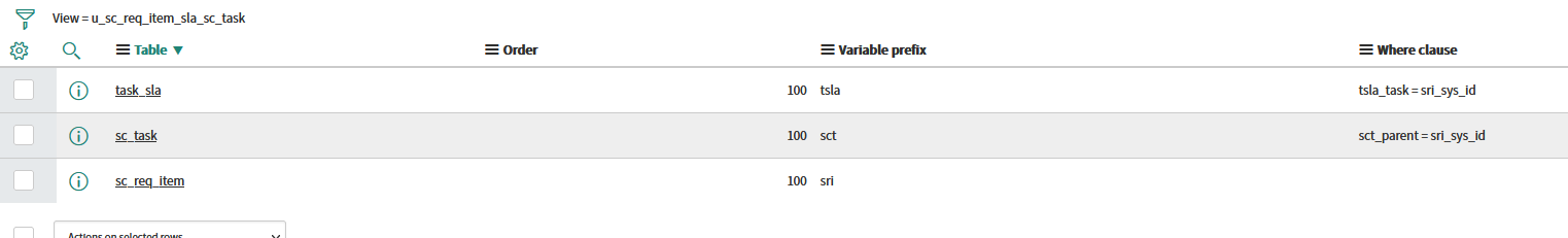

@ladrake I'm looking into this myself for a requirement. Did you have any success creating a database view? I'm having a hard time figuring out the Where Clause. Thanks!
Russell, I did not build a database view as this effort got deprioritized.
Understood. Thanks for the reply. I did do some more looking in to this and I have it working. For reference in future if the need returns see the image below.
