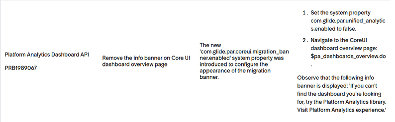

I was able to follow instructions from Zurich Patch 8 Release notes in PRB1989067 as outlined below and it worked for me. It may depend on what version your instance is currently on.
Here's the link and you can CTRL + F for the problem record to find it faster if the image is giving you any issues: Zurich Patch 8 • Zurich Release Notes • Docs | ServiceNow
For our platform, I also needed to follow instructions on how to remove that banner from the report home page, so you may want to check and see if you see it there also as outlined in this Support KB article: It's possible to hide info message: 'If you can't find the report you're looking for, try the Platfo...
