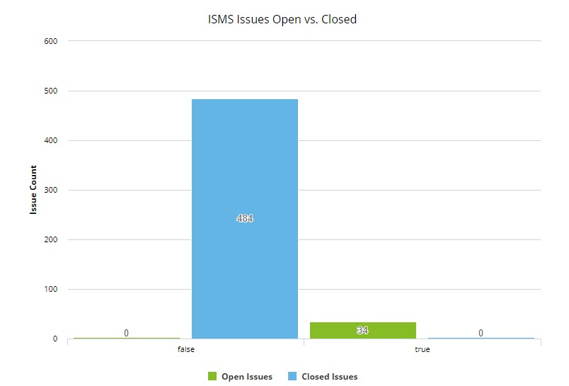

I'd like to run a report on Issues in the GRC Module for Open vs. Closed.  I can do this via the Active flag.  Business wants it to say Open for Active and Closed for Inactive.  Is there a way I can change the Label in the report or another way of doing this?

Thanks, I did try that.
Any idea how I can get rid of the 0's and remove the True/False at the bottom?  I might be able to use this, but the team wants a Pie chart.
You wont be able to change the true/false because its a tick box (true/false field) your reporting on.
The only way you can do it is to create a new field which looks at the true/false and translate it. Easy way is to create calculated field with the below script.

Only drawback is that it will only show on records updated after you have implemented the change so historic data unless its been updated wont be visible.
