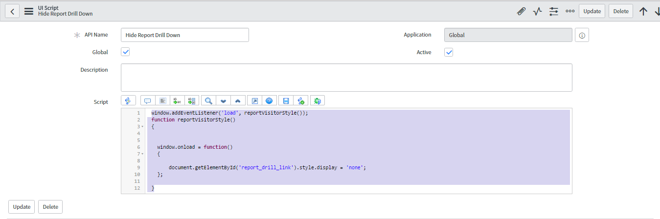

Most probably,the options which are visible under the Drop Down menu of the Report Page like Report Drill Down are not accessible for users to modify. One way to Restrict Users from using that Option would be to disable it and Can be done using some DOM scripts as mentioned below:
1) Create a UI Script as mentioned below:
Script:
window.addEventListener('load', reportVisitorStyle());
function reportVisitorStyle()
  window.onload = function()
    document.getElementById('report_drill_link').style.display = 'none';
Make sure the Global checkbox on the UI Script form   is marked as True. This will do the trick for you.
Although DOM is not recommended, but I think this is the only option to Restrict Users from using Report Drill Down option.
Hope this helps.Mark the answer as correct/helpful based on impact.
