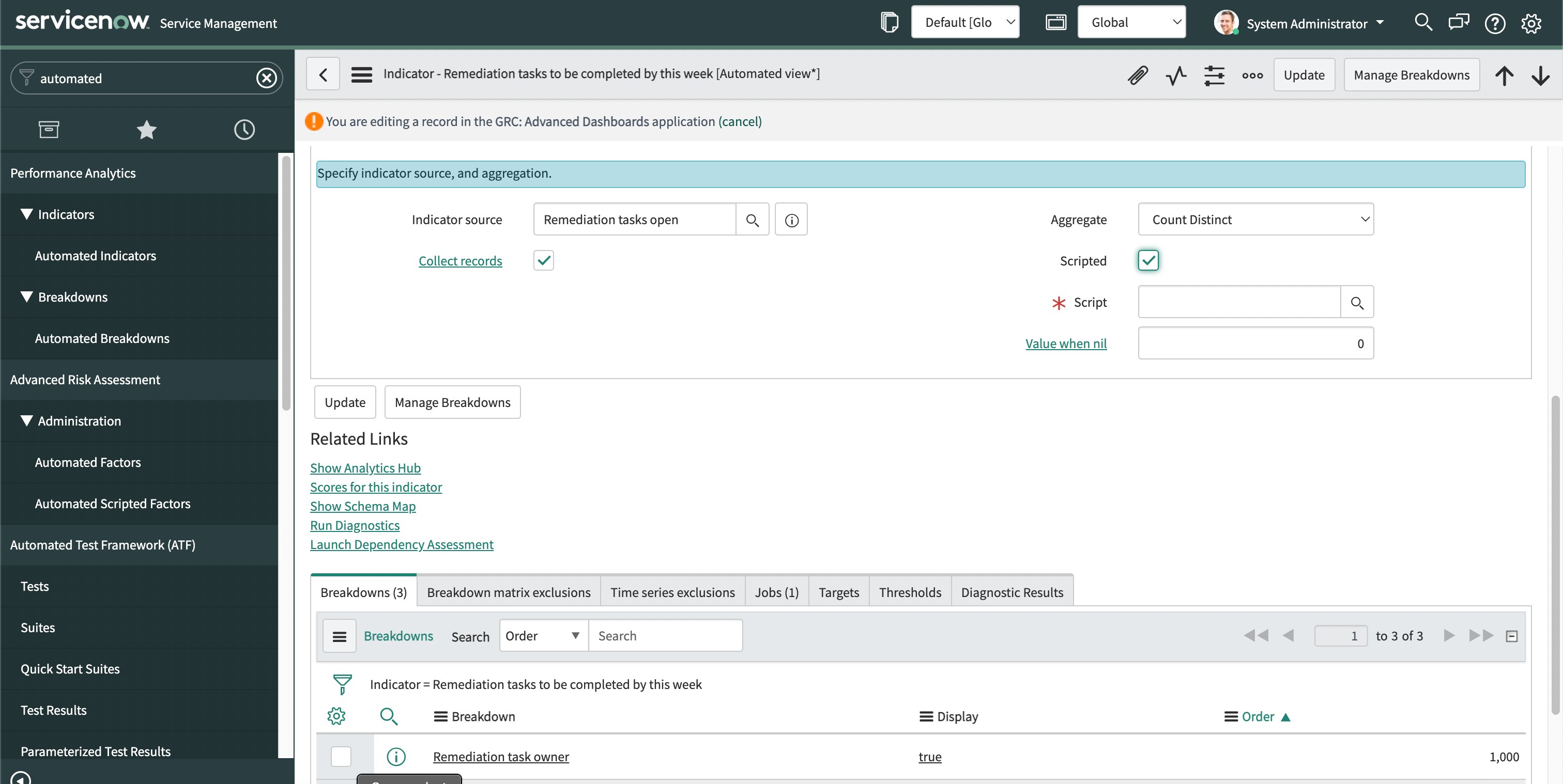

Hello @Jeannie Taylor ,
good that you are following PA as an approach in your PA script you can write like this
Give the aggregate as count distinct and select Script option and tag your script .
And in fields you can give your two date fields impaired time and created on
You script can be like
Replace you impaired time field name in below script
