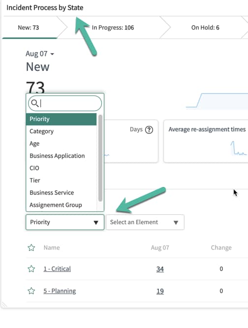

You can see here that I have selected Assignment Group - SAP Support at the dashboard level, and my widget is using State:
If you select a breakdown at the dashboard level when using a workbench widget, know that you will not be able to select another one on the Breakdowns tab in your widget:
If you don't have a breakdown selected at the dashboard level, it will open the ability to select different breakdowns at the widget level:
So after all of that explanation, if you have Breakdown Matrix selected at the Indicator level, you can do some of what I think you are asking for.  You can select to different breakdowns on the Analytics Hub. On your dashboard, you can only select one breakdown at a time at the dashboard level, but multiple elements within that breakdown.  If you have a widget that is already broke down my something, you can use it together with the breakdown on the dashboard.
