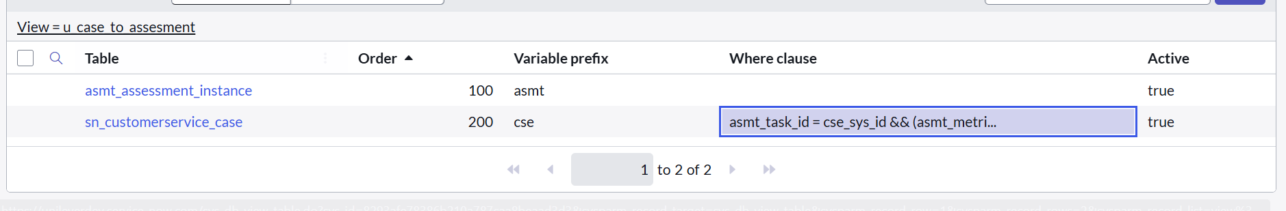

Need to join case table with asmt_assessment_instance table . I did but only getting 7 record
priyankar umesh
I joined asmt_assessment_instance table with case table . please see my where clause
asmt_task_id = cse_sys_id && (asmt_metric_type='855bde6f1bcf22502b80ea82b24bcbdd' || asmt_metric_type='a19ea66b1b8f62502b80ea82b24bcb7c') since I only want to include two specific metric type .
I m only getting 7 record that too only belongs to one metric type . please help.

Hi Mathew
I tried replacing with OR , its showing error . Also I checked sysid it belongs to  asmt_metric_type. Also I tried joining with asmt_assessment_instance.asmt_task = case.sys_id
Still none of then is working as I am not able to see any record

Hi Brad
While using only one sys id still i m able to see only 7 record (same) don't know what is the issue
