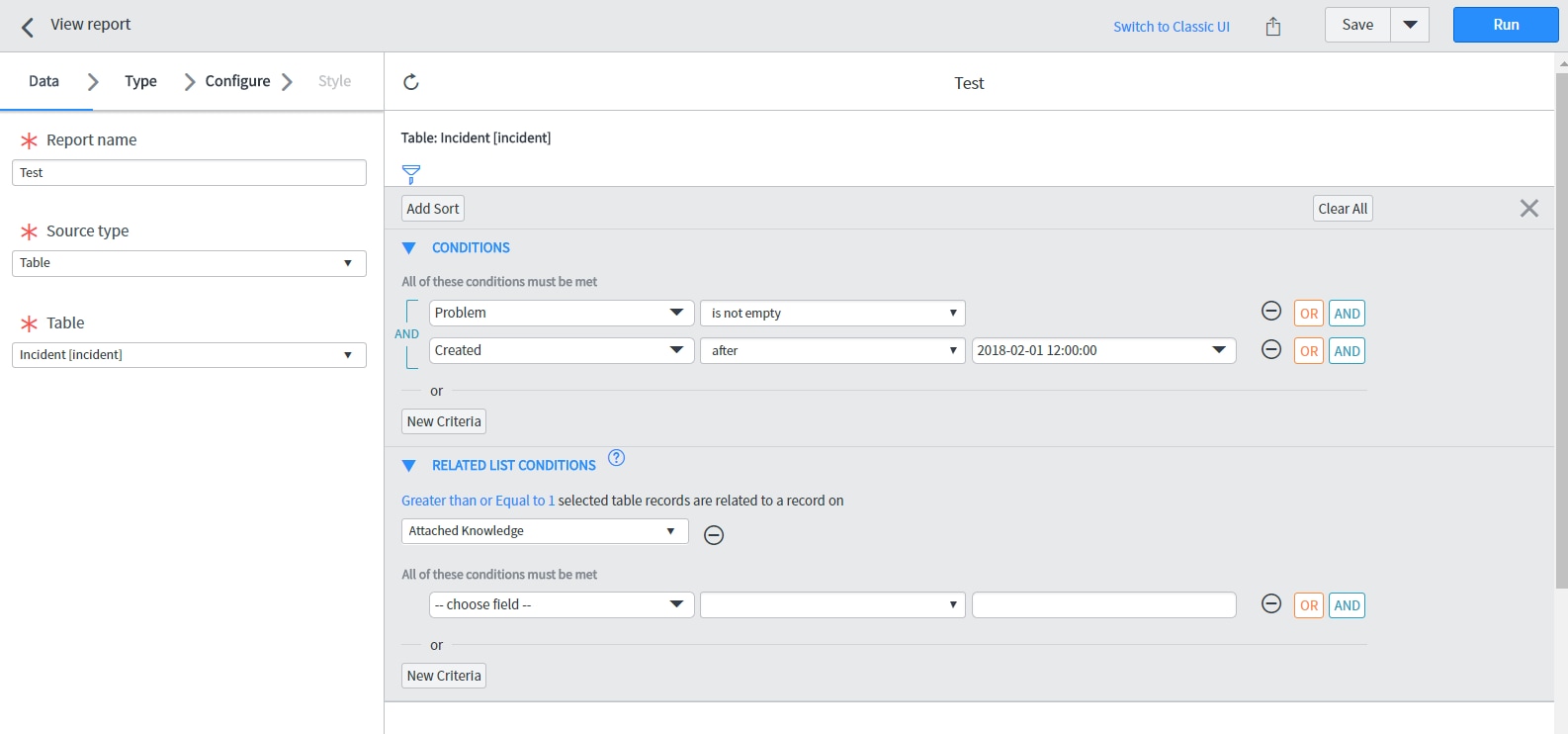

After playing with it a little bit more. The New UI for Reporting includes the ability to use Related List Conditions. See below:
Funny how digging around can identify solutions!
