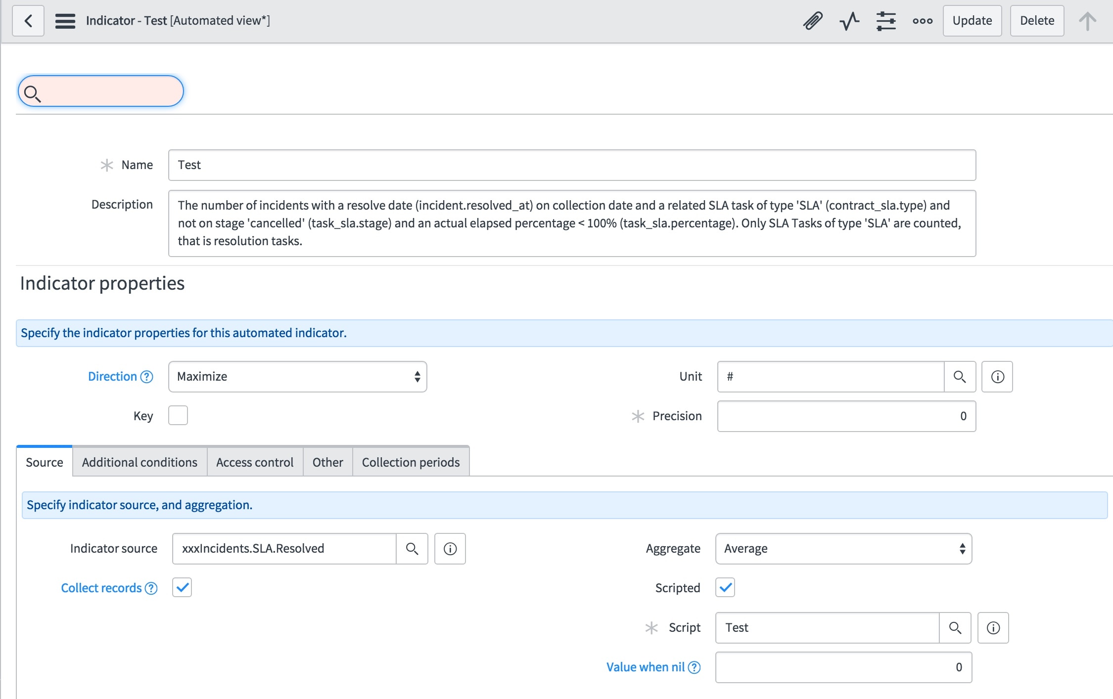

I just tried the above and I got a result although in my test environment I had to make sure that the 'actual elapsed time' field had values. Below the configuration.
And here the result.
The result is in milliseconds. If you want to manipulate that you will need to use a script in the indicator definition.
And the script will look like this if you want to convert to seconds. Of course you can convert to other units (like hours or days) too by changing the formula in the script.
Alternatively, it is also possible to convert from milliseconds by using a formula indicator with the indicator that takes the value directly from the field (first screenshot).
Best regards,
Erik
Best regards,
Erik
Ps duration fields are particular difficult to work with but not impossible.
I just learned that prior to Helsinki the direct configuration on field in an indicator returns no values for duration fields. So safest is always use a script.
Thank you, Erik! We are heading in the right direction and are seeing data being reported in our indicators. Thank you for the help!
