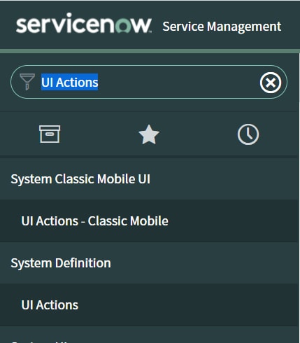

Couple of things to note here:
1) OOB there is no way to update the quantity as the field is a Read Only one.
2) If it is a One time activity you can write a Fix script and use the script shared below by Scott which will work. With Fix Script you do not need to write it every time and can execute it when you ever you want and also can be moved via Update Set as well to higher environment.
3) Alternatively, just to enhance this may be you can build a button on Consumable Form and make it visible to Admin, and they can update the Quantity using that button and every time they did not need to Run the script as well.
