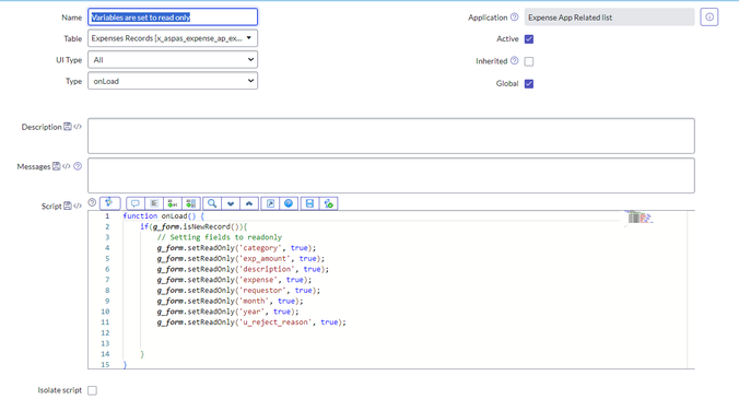

I am trying to prevent users from editing their records after they were submitted.

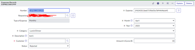

Here is a preview of the record:
All the fields should be read-only:
Here is the client script I have created but it does not work as expected:
01-05-2024 03:54 AM
So on existing record they should not be allowed to edit?
then simply update the IF statement as this -> use ! so that the IF runs for existing record and makes fields readonly
if(!g_form.isNewRecord()){
// your code
