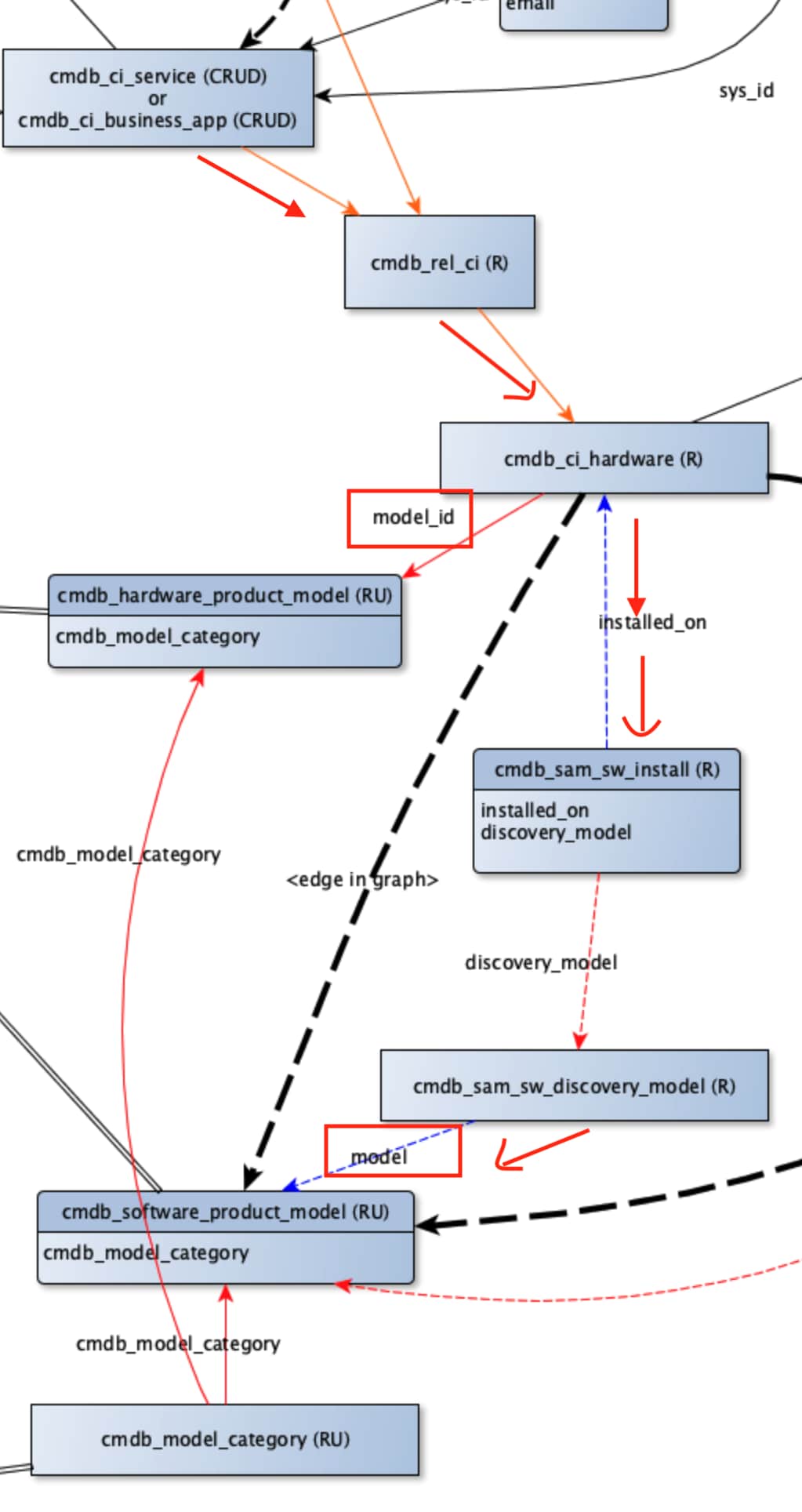

Hi Thank you for your reply, this makes a lot of sense, I guess my question is around this graphic in particular, if you see the flow of links between the ci_service record right down to the software_product_model. Due to the process between the discovery_model table and the SW model table now, is there a similar flow of links that I could derive in SAM Pro?
Direct link between a CI Service/Business Application to its respective Software Product Model
Thank you again
I see - out of box in software model table nothing like this is available. But I poked around in schema and found there is a link between Business App (cmdb_ci_business_app) to software model. So you should be able to create a view picturing model with business app
I found another interesting one CI Server to Asset. Please mark helpful or accept solution so that it helps others with a same question. find_real_file.png
