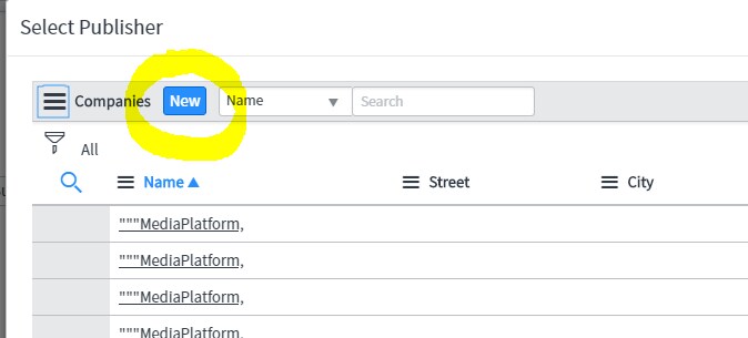

if you go to the Custom Software products you can create a new SOFTWARE package.   If the publisher is not yet available  you leave the field publisher open click on the magnifying glass.
this will open the Publisher table.   There you can create a new record and you should be fine.
 and now you can create the new publisher.

You mean to say the Company is the Publisher >
I am able to create a Publisher now but we have a field Web Pages where i need to place the URL, do you know on which table i can find this fielld since on the Software Model table it is setup as Read only .
