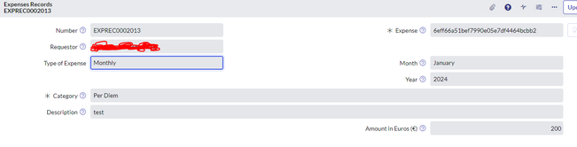

I set everything to read only so on a form it is impossible to edit values:

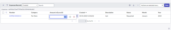

however, in the list view it is still possible to modify the values:
How this can be fixed?

This is easily achieved with an ACL using the Operation value of 'list edit'.
Have you locked the form/fields down via UI policies or an ACL? If you've used an ACL, simply insert and stay on the existing ACL and change the Operation value - job done.

Hello @hadron_collider ,
You can create list edit ACLsomething like below. Were you can restrict users based on this. In my example I am using * level ACL, you may probably need field level ACL as well if you already have list edit field level write ACLs.
