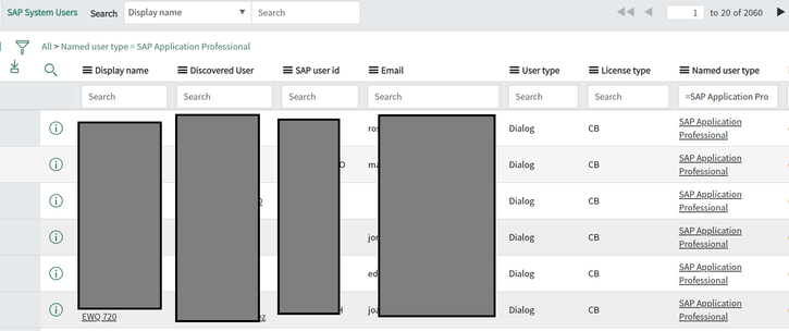

Could you provide me with some advices in order to troubleshoot the sap reconciliation?? I recently connect a SAP instance with SAM, but the reconciliation didn´t catch the used sap user licenses.

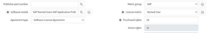

In one hand, I created an entitlement using the automatically created (by the integration with sap) software model. I'm sure the software model has the product=Named User.
In the other hand, I have many records pulled from SAP instance integration. These records represent the licenses used coming from SAP and are stored in the "samp_sap_system_user" table. These records are related to the same "Named user type"(validated with sys_id) (I'm hidding the personal info)

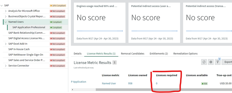

Finally, in the reconciliation result the licenses required appears a 0, and in my understanding it means that reconciliation process didn´t count the licenses used coming from "samp_sap_system_user" table

  1. Check the Entitlement configuration:
Verify if the entitlement you created is configured correctly.
  • Navigate to "Software Asset" > "Entitlements."
  • Open the Entitlement you created for the Named User licenses.
  • Ensure that the "Software Model" field is set to the correct Named User license Software Model.
  • Check if the "License metric" is set to "Named User" or an appropriate metric for SAP user licenses.
  • Verify if the "Start date" and "End date" are within the range of the reconciliation period.

  1. Review the Reconciliation Logs:
Reconciliation logs can provide valuable information on any issues encountered during the reconciliation process.
  • Navigate to "Software Asset" > "Reconciliation Results."
  • Open the reconciliation result for the SAP instance.
  • Check the "Licenses required" field to see if it is still showing 0.
  • Review the "Details" and "Messages" tabs for any error messages or warnings related to the reconciliation process.
