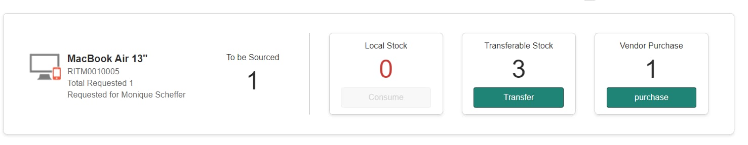

I am trying to figure out how "Source requests from local stockrooms" needs to be configured.
Is is a new feature available from Quebec.
I have set the property glide.asset.procurement.sourcing.local_stock_transfer to true, which gives me the 3rd option when sourcing a request.
I have to use the sub-worklfow in order to create the proper task(s) to deliver the asset. So far so good.
However I cannot figure out how I can get stock in this local stockroom. It is not a "regular" on-site stockroom. (In fact also my On-site stockroom is only accessible via Transfer)
It should look like this:
With in the documentation I can not find any information that can help me solve this challenge.
Can anyone advise?
Thanks in advance.

I have set up a stockroom of type "On-Site", and can add assets to it by receiving a purchase order or transform from another stockroom. But stock in this onsite stockroom cannot be consumed as described in the docs "" Source requests from local stockrooms
So how can I receive Stock in a Local stockroom so I can "consume" this.
