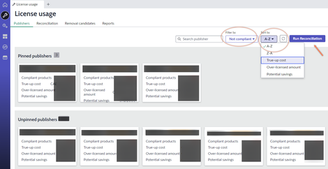

@Fred32 In SAM Pro, you can use the Software Asset Workspace to view the non-compliant software products/models. Under License Usage > Publishers, it will list all Publishers you have, and you can filter it (All, Compliant, Not Compliant) or sort it (A-Z, Z-A, True-up cost, Over-licensed amount, Potential savings). This is based on the reconciliation results (samp_reconciliation_result) which runs every week, or you can run it manually for specific Publisher, Group or Sub-group. This however doesn't show your requirement of 3 months consecutive non-compliant but only shows the result at the time the reconciliation runs (e.g., Note that you may have a Publisher shows as compliant yesterday and shows as non-compliant today, you will then need to investigate further).
I would recommend reviewing the list of non-compliant Publishers and based on risks (audit) and $ value, figure out which ones you should prioritize (and pinned it so you can easily view it). Note that there are a number of reasons why Publishers are showing as Not Compliant in ServiceNow (e.g. SW model not available but discovery shows software as installed, not enough entitlement rights, etc.).
Below sample is my personal view only (I only pinned 3 main Publishers), hope this help!
