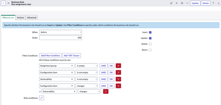

There is a OOB business rule "Run assignment rules" on Vulnerable Item table that triggers assignment rules on insert/update:

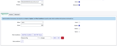

We also created another BR on discovered item table that triggers assignment rule if resource tag of discovered item changes
Could any of these business rules be the reasons for running the assignment rules again?
Should I set active is TRUE condition on the BR?

There is a OOB business rule "Run assignment rules" on Vulnerable Item table that triggers assignment rules on insert/update.
We also created another BR on discovered item table that triggers assignment rule if resource tag of discovered item changes.
