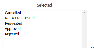

I'm wondering if the issue is simply that you are setting the request.approval field to a value that does not exist for that field. Right click the 'Approval' field on the Request form and click 'Configure Choices'.

You'll see the choice values for the field.

Unfortunately the value 'cancelled' is not a value for sc_request.approval. The 'cancelled' value that you probably see in the dictionary refers to a different table called Group Approval.

But If you really want to set your approval field value to 'Cancelled', then simply add it in the Configure Choice page. It would just be for show though.
After you create your new choice field called 'Cancelled', right click the Approval field, go to 'Show Choice List'   make sure to set the value to 'cancelled' and label as 'Cancelled' as shown below.
