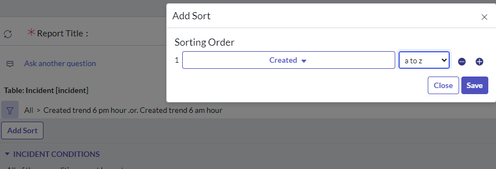

Thanks @AndersBGS ! This is a "better than nothing" solution. But how do I get the hours in order on the X- axis like you?
This is what I get:
With a filter like this:
And here with using date, I would like to have the oldest date at left and the newest at right at the X- axis.
‎01-10-2024 10:59 PM
Hi @AdamUMC ,
Try to utilize the sort under the filter condition and sort by created A-Z.
Best regards
Anders
‎01-11-2024 12:42 AM
Thanks! I forgot this option totally. It's a small button, not very visible.
