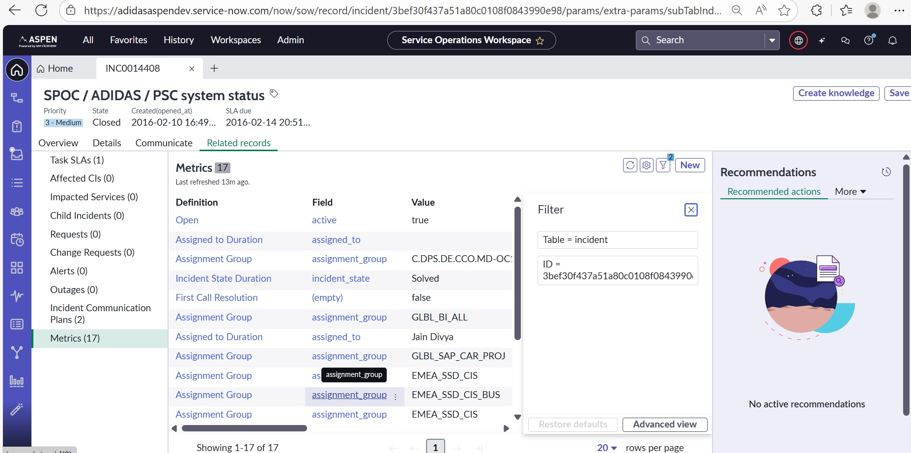

Need help to change/Remove default filter for incident related records Metric Tab in sow workspace.
I need some assistance with an issue I’m facing in Operations Workspace.
Whenever I open the Incident list inside the workspace, it always applies an OOB default filter like this:
Table = incident
ID = <sys_id>
I’ve already explored the following possibilities but without success:
Checked UI Builder for the list component → no default condition defined.
Checked UX screen conditions → nothing found.
checked sys_filter table -> nothing found
In the native view, I created a new filter and saved it as default.
In Workspace, I can see my new filter along with the existing OOB filter.
But when I refresh the Workspace, my filter disappears and it reverts back to the OOB filter.
So far, none of the above has worked. I need guidance on how to remove or override this default OOB filter in Operations Workspace.
Any help would be greatly appreciated.
Thanks in advance!

@Community Alums The screenshot you attached are of related list in incident record. Related records like problem/changes/Task SLA has to be shown which are related to the incident you opened so there has to be a filter.
If Filter is not there, it will show all records. What is your exact requirement?
@Raghav Sharma24   thank you for responding. you can see the attached screenshots
Hi @Community Alums ,
Since you have added the metric instance table on the related list, the filtering of INC happens. I don't think you'll find it in the UI Builder. You need to check the related list backend (whichever table handles the related list).
Since the requirement is related to reporting I suggest you change the solution approach and build a different dashboard for this requirement.
