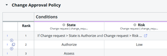

05-06-2025 02:13 PM - edited 05-06-2025 03:06 PM
@Samiksha2 - After you create new Decision and define Answer (which will contain the response to whom the approvers should be routed to) you need to update the "change approval policy builder".
Open the "Decision table" > then > "Change Approval Policy"
Under the change approval policy you can copy the one you want to have additional approval. In your case "Authorize" and then update the change approval definition you created. To do that you have to scroll to the right...
