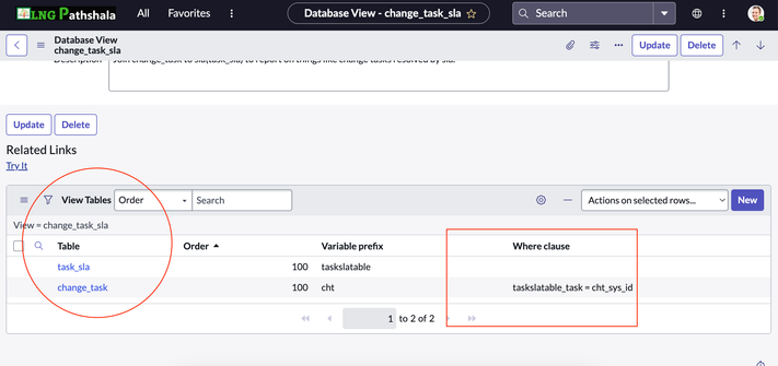

Dr Atul - LNG
Hi @nowdev777
A DB view is used when you need to join two or more tables. In the first table you showed, what is the second table? Also, without a WHERE clause, it won't work. You can check the OOTB database view for clarity, mate.

Hi @nowdev777
I believe database views can be of a single table, right?
Atul: No, DB only work more than 1 table.
I don't think this is whats causing the issue.  To me I believe this is some sort of a permission issue but I have no idea how to resolve it. I have added a where clause as you suggested and am still getting the same results.
Atul: Which other table you add where clause?

@Dr Atul - LNG
