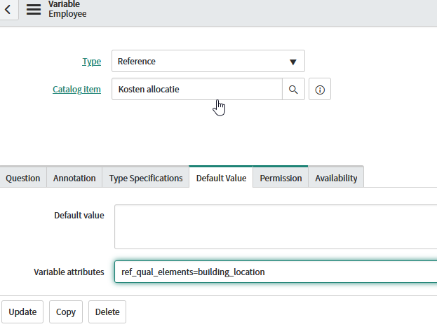

Have you added the 'ref_qual_elements' attribute?
Like so:
ref_qual_elements=building_location
Just added that in to Variable Attributes, unfortunately same issue. Works with Try It, not working in Portal.
