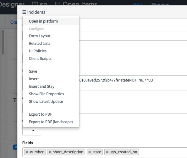

What I've done is create a new page, then on that page add however many "Data Table from Instance Definition" widgets needed. Each of those widgets can be edited. I had to add several fields to the form that weren't there in the default view to get it to work.
Here's a pic of what the form should look like when you've added the fields you'll need to configure the widget properly. *select open in platform from the hamburger:
