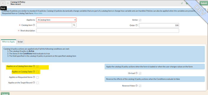

Hi @Steven Watts2,
This is absolutely possible.
Can I just clarify a few terms you've referenced?
When you say it should be hidden on the 'catalogue item', but visible on the sc_task... so you mean the 'Request Item' record (Table: sc_req_item) or do you actually mean the 'Catalog Task' - a child of the Request Item?
I've tried and tested this on my PDI and have simply ensured a checkbox on the UI Policy 'Applies on Catalog Task' is not checked. I can confirm the field is hidden on the Item and is visible on the Request Item.
See screenshot below:
To help others (or for me to help you more directly), please mark this response correct by clicking on Accept as Solution and/or Helpful.
Thanks, Robbie
