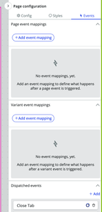

We can do it by dispatching "SCREEN_STATUS_CHANGED" event with a payload { status: "closed" }
Add a new dispatched event in Body component named "SCREEN_STATUS_CHANGED" and add payload using advanced flag as "status" as string.
On your event handling for the button, add SCREEN_STATUS_CHANGED event with the payload status=closed and save it.
Now when you click on the button, it will close that tab.
