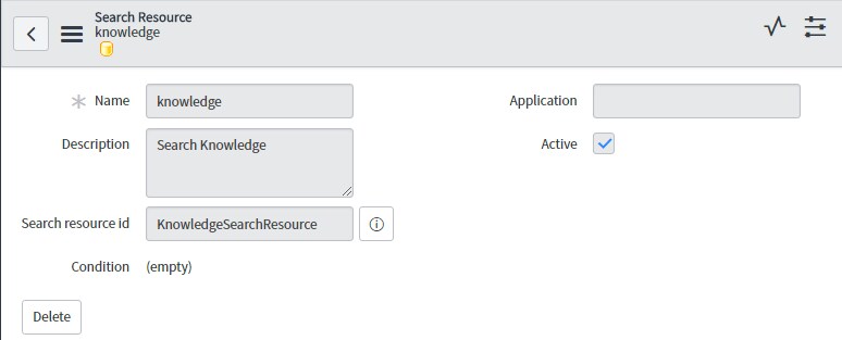

02-26-2018 05:33 PM
Hi Chris,
I also need to do this but no matter what screen I go to (whether an OOB or custom), I am unable to edit anything. Is there something I can do to make these editable?
Uneditable OOB Knowledge resource configuration for Incident Deflection:
Custom search context showing I am unable to add a new Resource Configuration:
