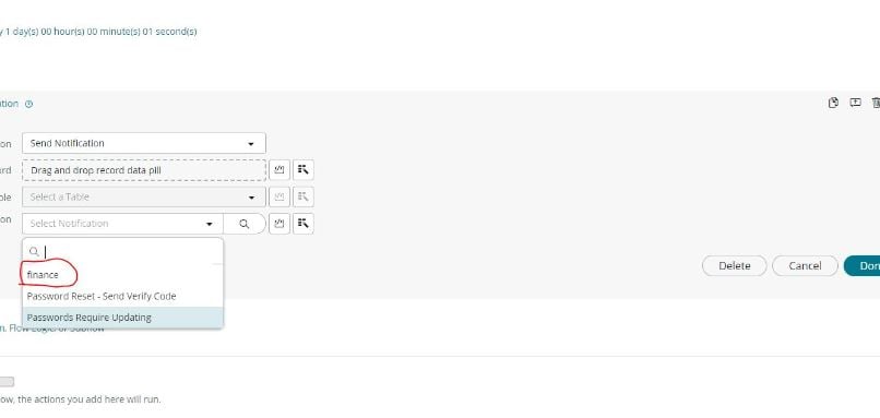

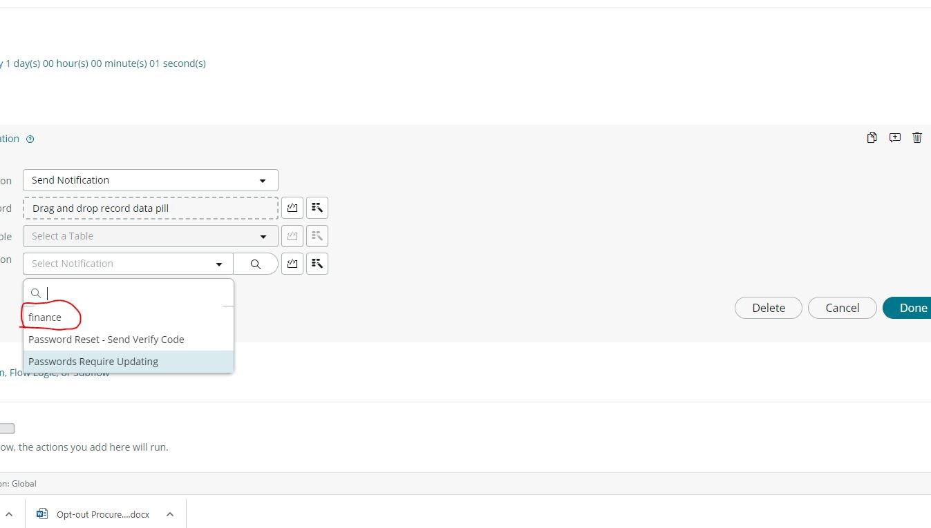

I am using a developer instance and want to run a flow that looks up a record on my custom table and triggers a notification to be sent.
The notification is using my custom table as I want to select the variables to use in my notification. However for some reason I can't see either my notification or table in the dropdown menus.
If I remove my custom table from the notification it shows in the dropdown, but I need to leave it with this table for the aforementioned reason.
I have checked also sys dictionary that the collection is set to true.
custom table added to notification (not showing)
table removed from notification (now showing)
custom table not showing either...
collection is active
