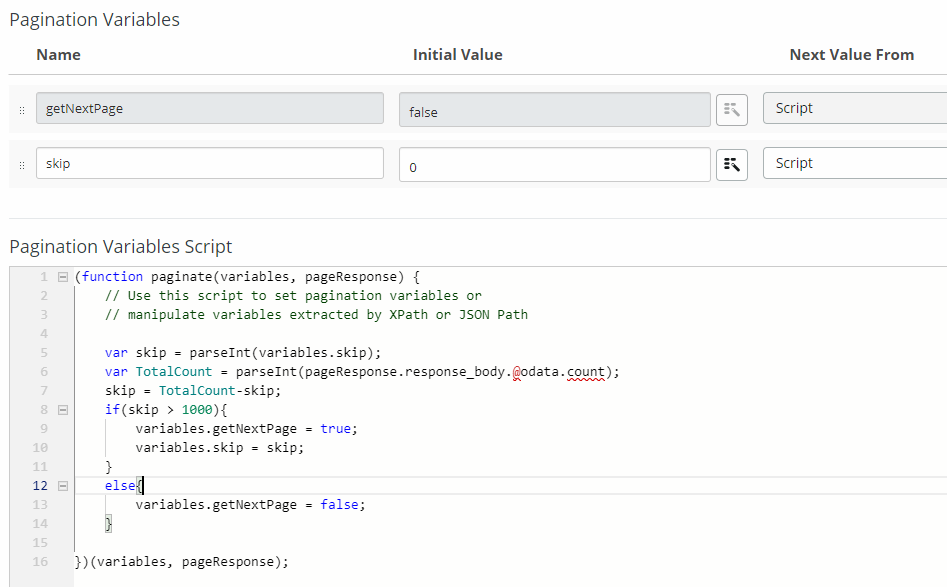

The response body from external system contains parameters "@odata.count" and "@odata.nextLink" which holds the next chunk results that needs to be invoked.
As this is from Response Body then on the below pagination expression is not working as expected.

Create pagination variable and read the content from the response body:
$['@odata.count']
where @odata.count is the variable from the response body.
This worked out for us.
